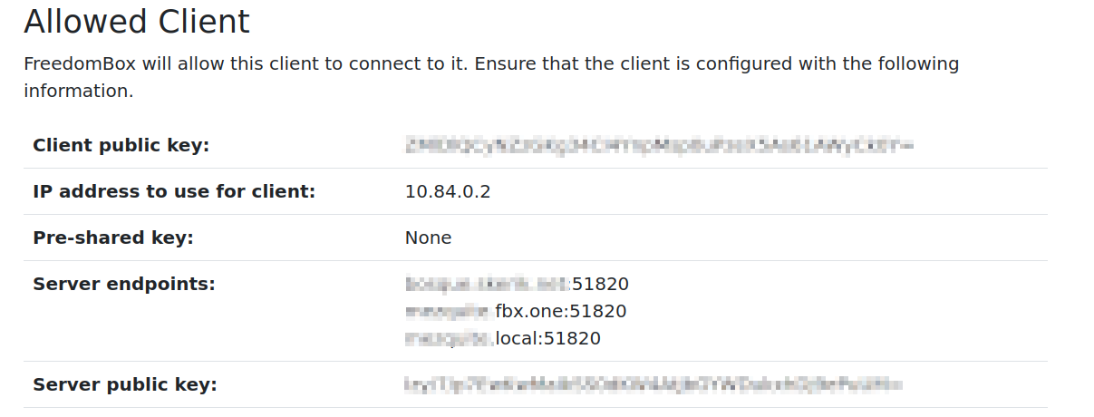

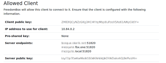

  6. Then the FreedomBox page gives you the other information to put into your client:
    1. IP address for client goes into the address field
    2. Skip the listen port
    3. DNS server will be FreedomBox internal IP (192.168.1.1 or something)
    4. Don’t change MTU
    5. Copy the server public key from FreedomBox and paste into peer public key
    6. skip pre-shared key
    7. you can skip keep-alive for now. Get it working and then try 20 which may save some battery.
    8. endpoint will be your FreedomBox DNS name (or static IP) with port 51820 (myfreedombox.freedombox.rocks:51820)
    9. Allowed IPs - this depends, but start with 0.0.0.0/0, ::/0 to tunnel everything.

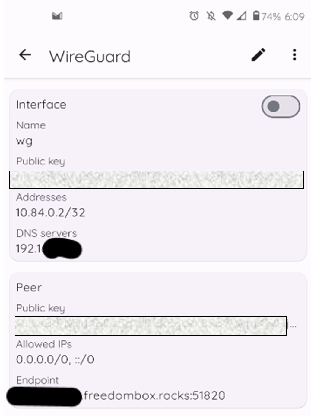

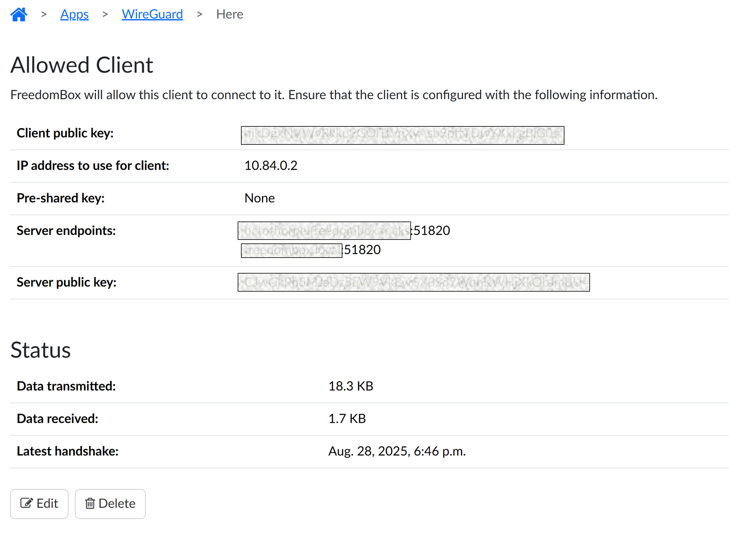

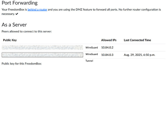

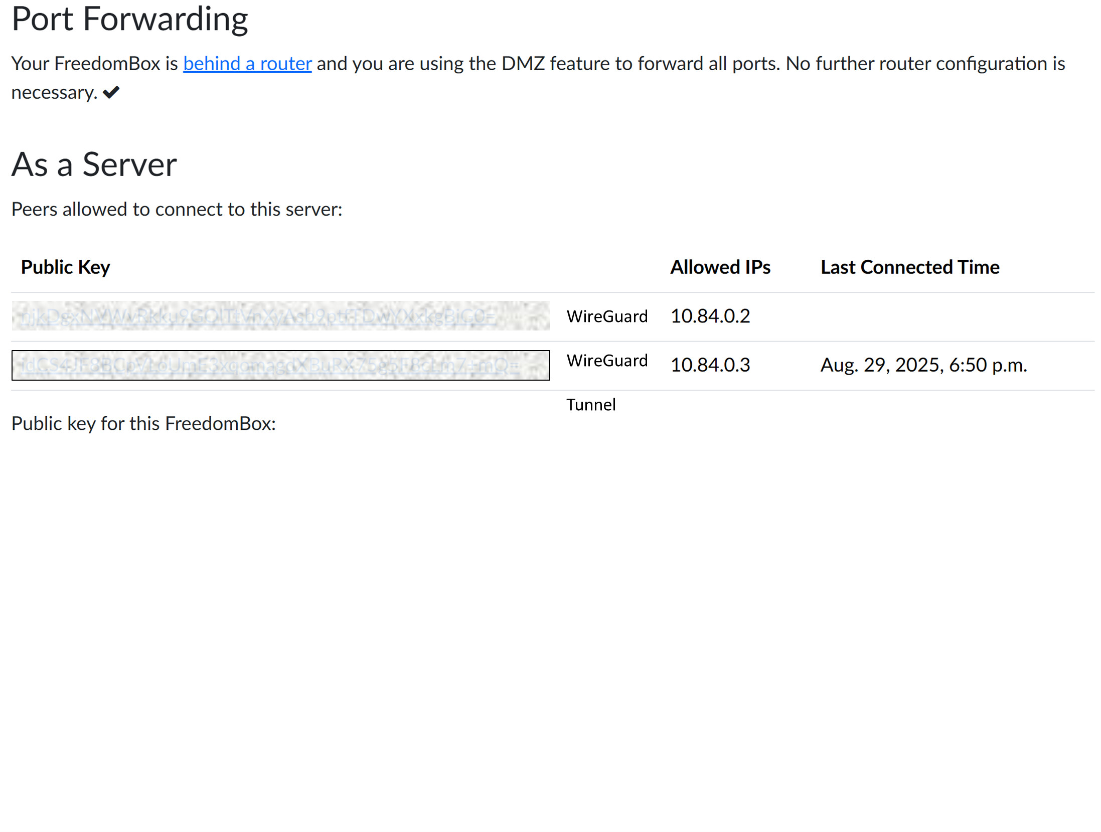

Here is a screenshot of the peers with the apps labeled. On my phone, the both show connected and the logs didn’t have any errors, but webpages will not load.
You are very close! You have VPN connected to Freedom Box.
Your client is 10.84.0.2
FreedomBox is 10.84.0.1
You have a successful handshake
There is some data transferred both ways.
You are connected to your VPN!

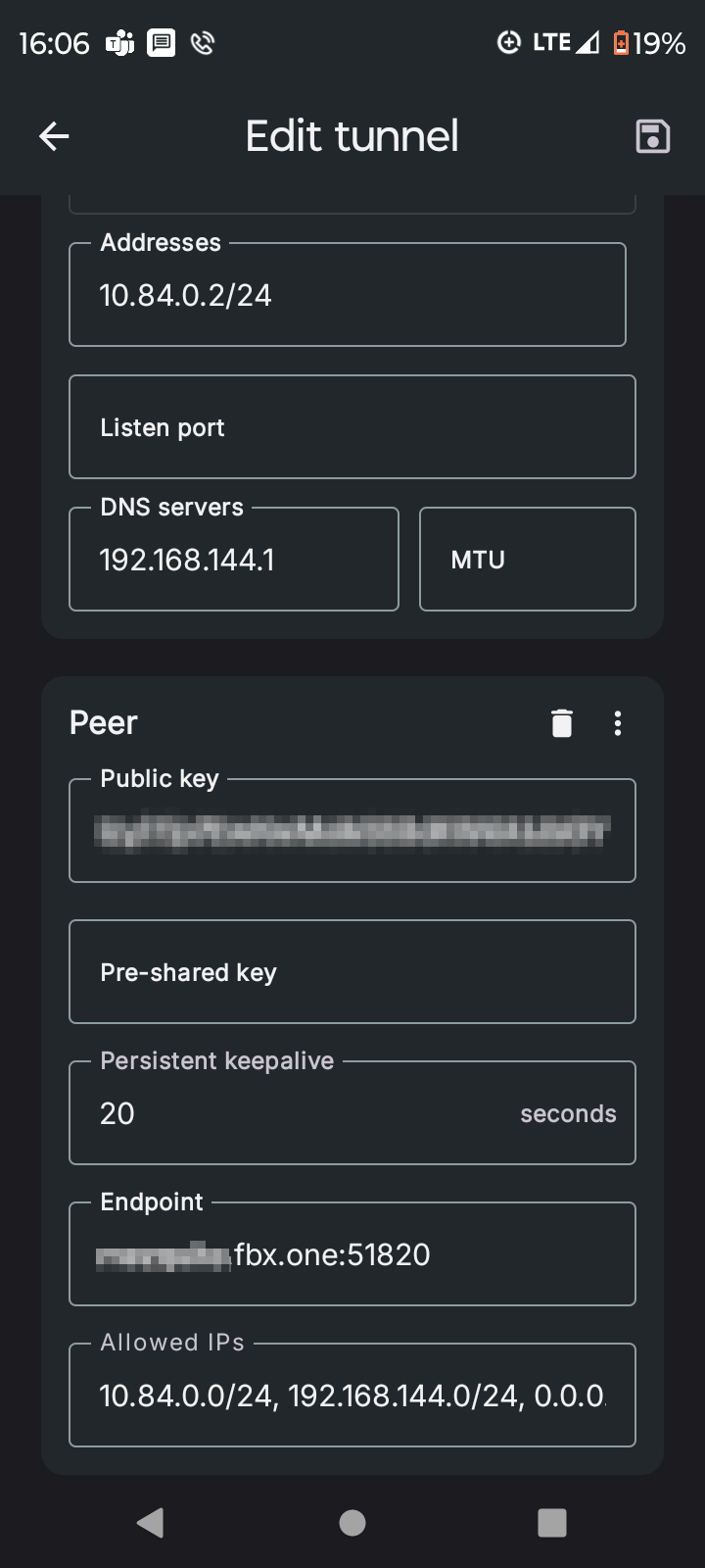

What is the client DNS server?
What is in the client allowed addresses field?
The client DNS server is the internal address of the Pioneer/freedombox. (Is this correct?)
For the allowed IPs
0.0.0.0, ::/0
Except to the keys, I entered the same information in the fields for both apps.
On the WireGuard Tunnel app, when it is on, it shows the IP address of my endpoint as the public IP address of the Pioneer/Freedombox.
DNS sounds right, but I don’t think you can get to it yet.

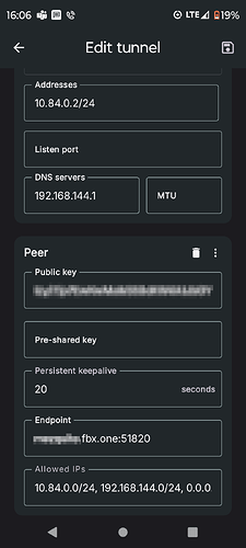

Try this, and leave out IPv6 for now…
Change your Address to 10.84.0.2/24
That /24 indicates a network instead of a single host. I think this is the issue. You can read up on netmasks and CIDR notation if you want to understand all this.
Then try this if that does not do it…
Allowed IPs
10.84.0.0/24, 192.168.1.0/24, 0.0.0.0/24
You may have to fix your 192… address to match your subnet. I assume you use a /24 with addresses .0 to .255
I have made the suggested changes and I am still unable to load webpages.
Here is mine, and it sounds like yours is similar.
Let’s recap where you are. Tell me if all this is correct:
  • You can connect your VPN and you see a successful handshake and some number of bytes are sent and received over the link.
  • Your DNS Servers address is the FreedomBox internal IP address
  • You have Allowed IPs of
    • 10.84.0.0/24
    • 192.168.xxx.0/24
    • 0.0.0.0/0

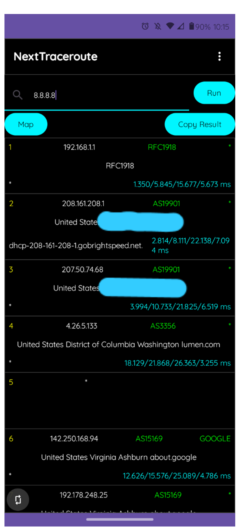

If that’s correct let’s confirm next that your FreedomBox has internet. From your FreedomBox do traceroute 8.8.8.8. There should be quite a few lines of output from this ending with something like this…
11 dns.google (8.8.8.8) 30.896 ms 30.974 ms 31.338 ms
If that is good, try it again from your VPN client. You should be able to find a traceroute utility from your favorite app store.
If that also looks good then do traceroute dns.google.com
That will tell us if the problem is routing or DNS.

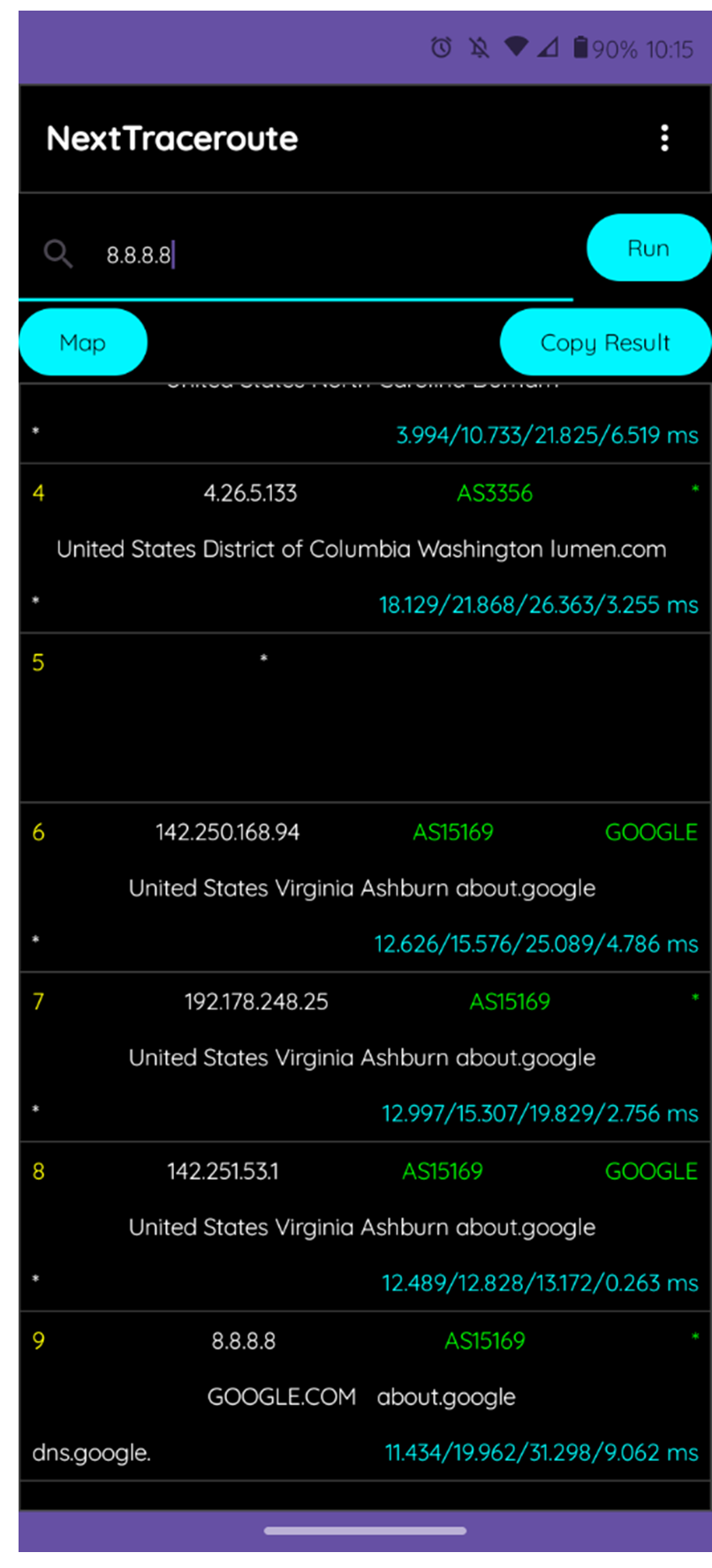

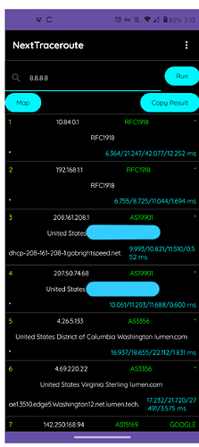

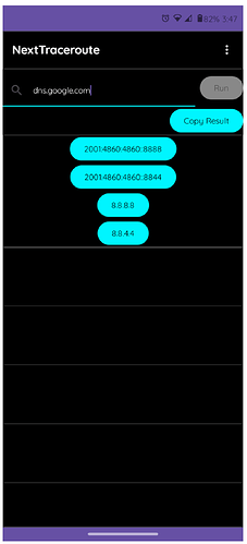

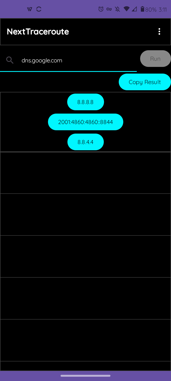

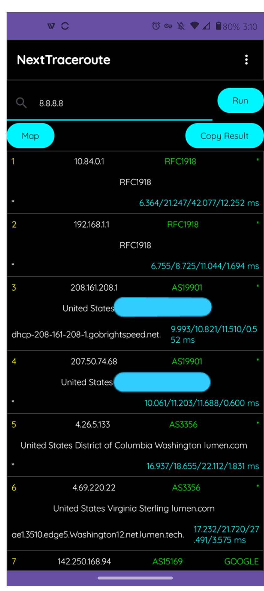

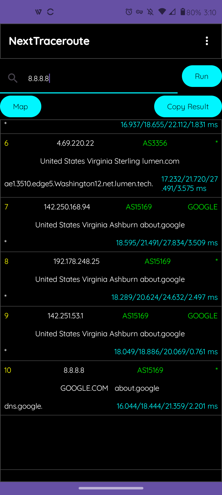

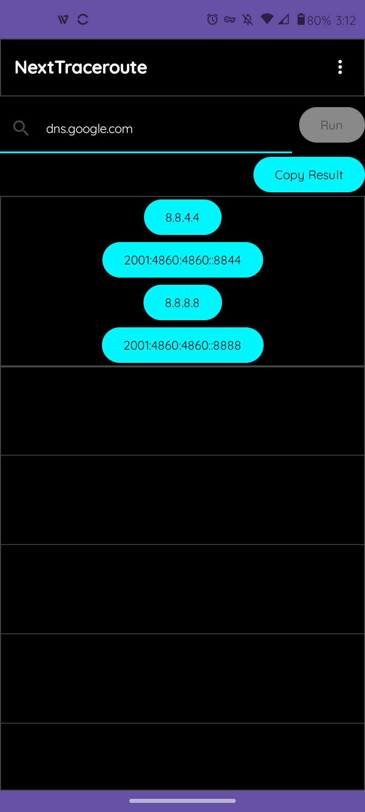

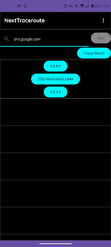

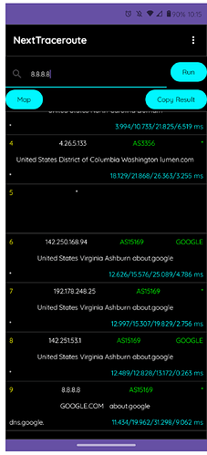

These are the results from the traceroute.
The app I’m using will not allow screenshots for WireGuard.
For the Pioneer/Freedombox:
traceroute to 8.8.8.8 (8.8.8.8), 30 hops max, 60 byte packets
1 through 6, then
7 * * *
8 dns.google (8.8.8.8) 12.468 ms 12.391 ms 11.948 ms

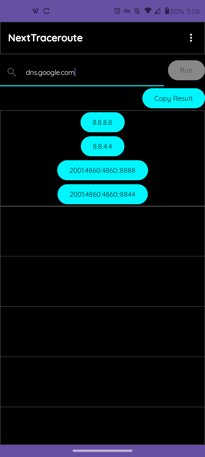

traceroute to dns.google.com (8.8.4.4), 30 hops max, 60 byte packets
8 dns.google (8.8.4.4) 11.875 ms 142.251.77.65 (142.251.77.65) 11.942 ms 11.507 ms

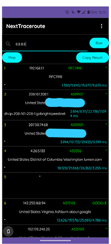

For the Client:
Good on the Freedombox.
Was the client on VPN? I forgot to mention that :slight_smile:
I suspect not because it got all the way through to the google.
*dies of embarrassment
My previous post was not on VPN. These screenshots are with the VPN enabled.
This is excellent. Traceroute tells you that you have internet using your VPN. So I think the only part we are missing is a functional DNS lookup from your VPN client on 10.84.0.2.

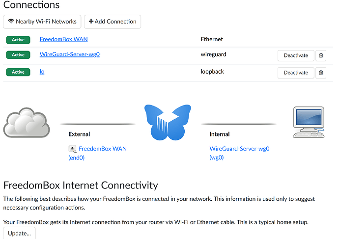

Let’s have a closer look at your FreedomBox next. If you go to the Setup / Network page down at the bottom…
  • what is your FreedomBox Inetnet Connectivity setting?
  • what is your Internet Connection Type setting?
Then go into your primary network interface and look at the Privacy setting. Which option are you using there?
Internet Connection Setting is from router via Ethernet.
Internet Connection Type is “My ISP provides a public IP address that may change over time.”
Privacy setting? DNS-over-TLS for both
I’m not sure if FreedomBox will serve DNS in your configuration. Rather than try to troubleshoot this, what if you set your VPN client DNS address to an external DNS provider such as 9.9.9.9? That may get you over the hump of not being able to load a web page.
