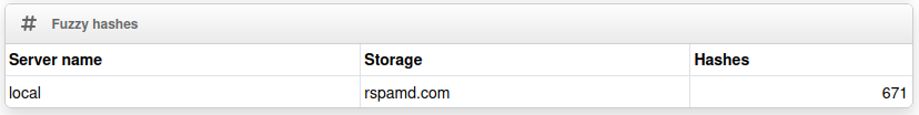

I just noticed on the RSPAMD web interface under Status, that counting the Hashes started by zero again. This is the reason the fuzzy errors no longer occur, I think. Before starting over again, the value of the Hashes went up into the billions and may filled a limited store?
To avoid fuzzy errors, does a earlier data dump (system) of the Hashes solve the problem?
It looks like the fuzzy error is connected with a very high value of the Hashes.
