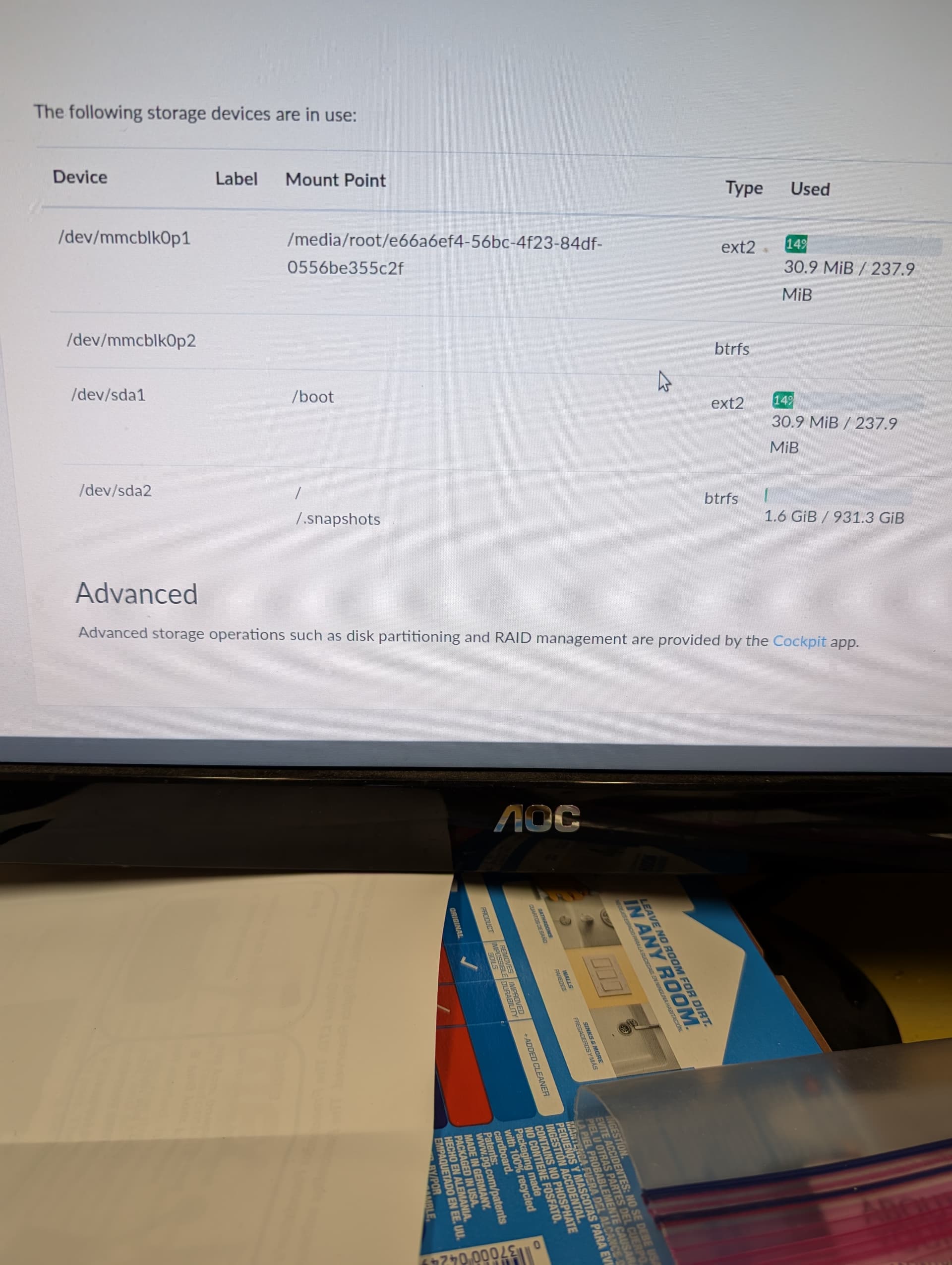

Although this is concerning
It seems you have /boot on the HDD. I did setup my freedombox from the original freedombox image and ran btrfs replace, then I still have /boot on the microSD card. So you probably did something else in order to have /boot on the HDD. I assume that the HDD is more reliable than the microSD card, so your setup looks preferable as compared with mine.
I am not sure why you are concerned actually.
I thought the Pioneer box needed an SD Card to boot up with. Also can I move root to SDA2 and snapshots to something else?
Nevermind. Root is where it should be on the hard drive. I just need to move snapshots.
