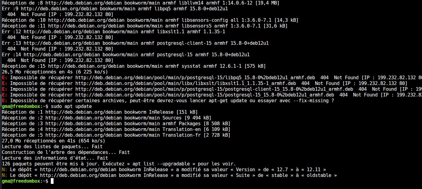

My system was messed by unwanted upgrade of my PostgreSQL from 15 to 17
I downgraded to old version. Noway, PostgreSQL from 15 binaries are removed.
Previous stable fresh installation also automatically updated to Trixie.
How to fix ?

I get this outputs

Thank you Ged, I’ve installed bookworm and trying to postgres15 packages
