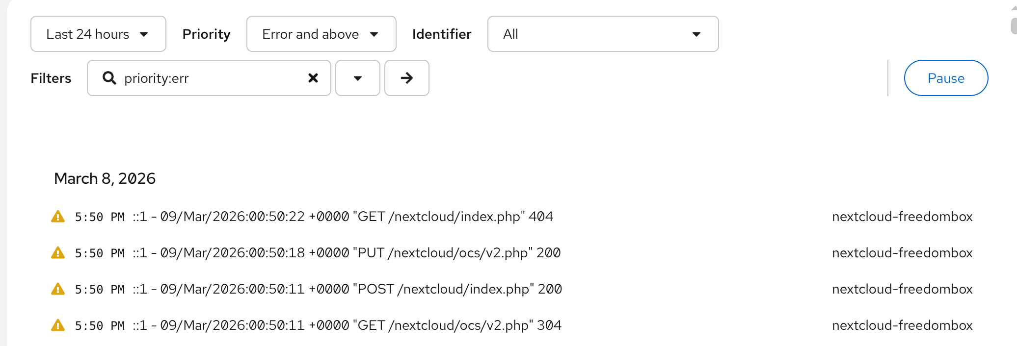

The filters cockpit defaults to look like this:
When I scroll back in the log that appears there, it seems to start when the machine was rebooted.
I was hoping to find some log info from when it stopped running to see whether it gave me any idea what made the system stop running.
Is there a better selection of the filters at the top of the log screen that would help me chase down what I am looking for?
Or maybe there is a better way to see logs from the previous session?
Any tips on where I should look to find my way around with this would be welcome.

There are a limited amount of logs stored which is probably configurable. I recall cockpit logs letting you go back a week for sure maybe longer.
There is a log level field allowing you to select the severity (debug, info, warning, error, alert, etc.) debug is the lowest severity and the highest is critical, I believe. You can filter the most severe which may give some idea about the biggest problem and maybe work your way down to see what was leading up to that.
  • after a crash change the date range to include the crash + at least a few hours
  • you have priority err, try a higher level to filter for most severe messages (critical, alert, etc. maybe error)

You can type search keywords in the field after where you see priority:err
The identifier field lets you filter for a particular service.
