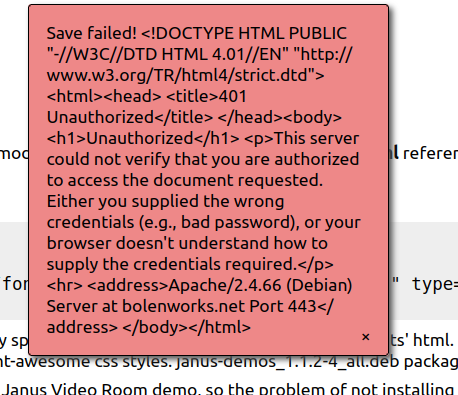

result, notification popup:
Save failed! 401 Unauthorized
Unauthorized
This server could not verify that you are authorized to access the document requested. Either you supplied the wrong credentials (e.g., bad password), or your browser doesn’t understand how to supply the credentials required.
Apache/2.4.66 (Debian) Server at homenet.net Port 443

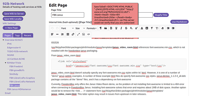

The notification error can be layered under some of the edit page UI.
