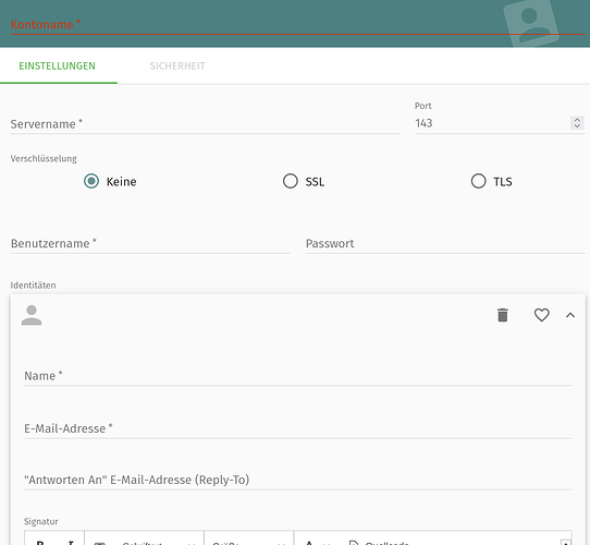

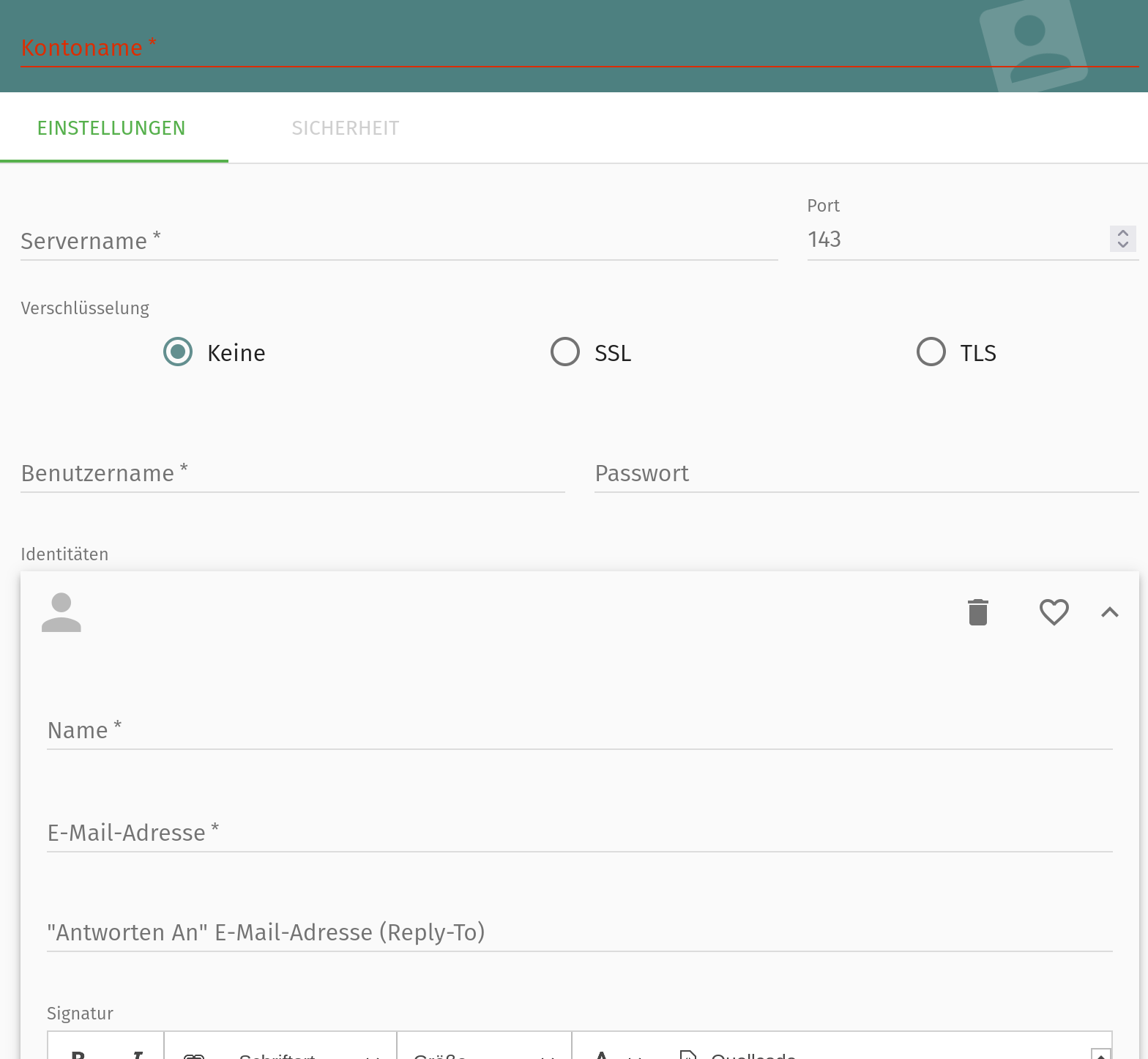

With this you can add multiple mail accounts under settings > e-mail > IMAP-accounts > new mail-account (I have it in German and did freely translate it).
I did test this feature and it seems to behave correct.
