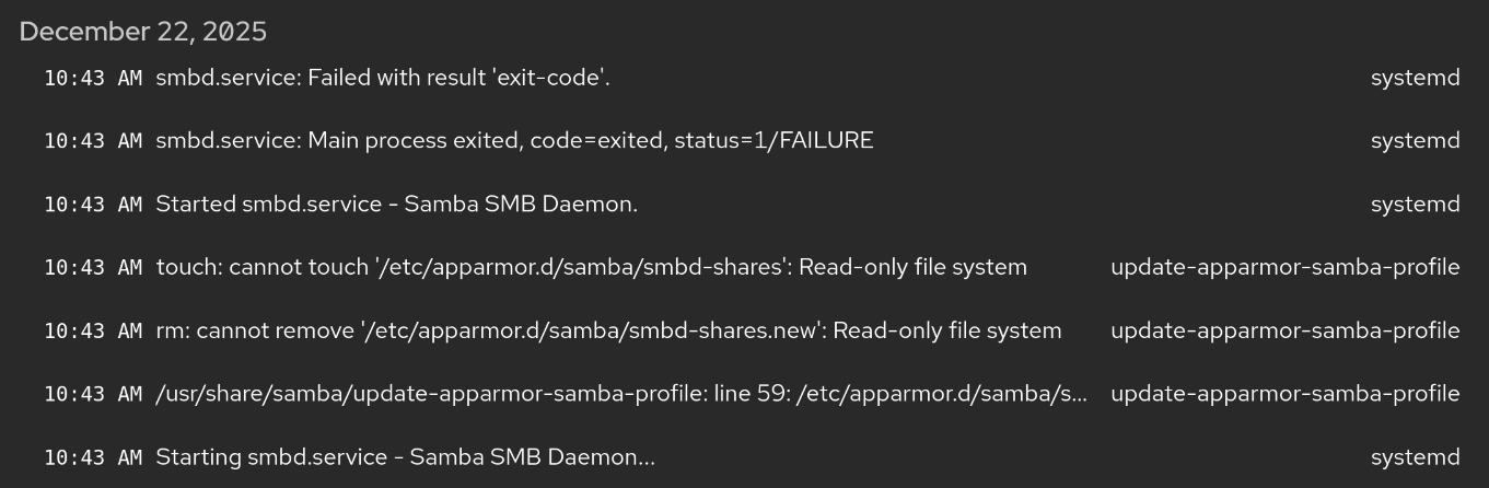

Samba service will not start. Logs report a problem with apparmor.
  1. Login to FreedomBox.
  2. Go to Cockpit Services
  3. See samba not started, start that manually
  4. Service attempts to start, fails, logs an error.
Samba service should start normally.
Error messages from Samba:
update-apparmor-samba-profile
/usr/share/samba/update-apparmor-samba-profile: line 59: /etc/apparmor.d/samba/smbd-shares.new: Read-only file system
The filesystem is not read only. The _UID field in the log entry is 0 (root). I was able to use touch to create an empty /etc/apparmor.d/samba/smbd-shares.new file as root. Permissions of this file and folder match others in /etc/apparmor.d.
I’ve also checked for apparmor profiles installed outside of packages using /sbin/apparmor_parser -N /etc/apparmor.d | xargs -i dpkg-query --search {} >/dev/null There are no samba related profiles not part of an installed package. Everything looks as-distributed here.
The solution in the Nmbd service post did not resolve the issue (explicit addition of local network address to firewall). My firewall configuration for Internal already included that interface and with all subnets before the change.
It appears the line 59 error is the cause of the next two errors. The apparmor profile should be recreated after every samba startup - so the .new file fails. The next two errors appear to be subsequent file operations using the .new file.

Currently the Samba app is not compatible with Apparmor. Seems like you have apparmor-profiles installed, you can disable the Samba profile with aa-disable /usr/sbin/smbd.
I created an issue https://salsa.debian.org/freedombox-team/freedombox/-/issues/2558 to make Samba work with Apparmor.
I’m comfortable with that given samba is an internal service. Thanks for sharing this!
Victory.
aa-disable comes from the aa-utils package which I did not have installed. A person wanting to do this needs to apt install aa-utils before using aa-disable.
Thank you for recommending this.
