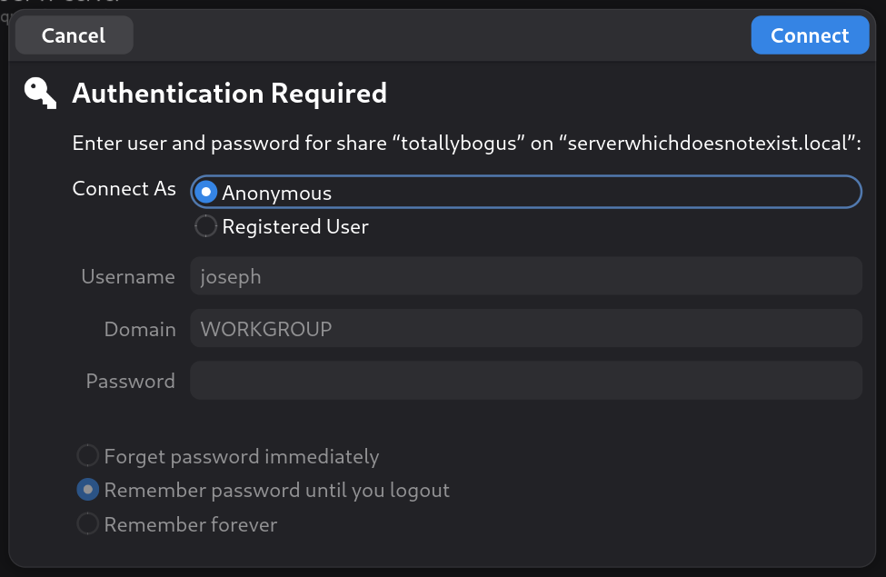

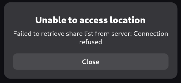

From Linux, depending on whether I use smb://<machinename> or smb://<machinename>.local I get different errors. The first alternative gets me a login prompt, but fails to login, simply cycles and prompts again for the username/password. The second option gives me Failed to open"File System". Failed to retrieve share list from server: No route to host.. Trying the same thing under Windows gives a very slow response but eventually also fails to find the share. Using the test machine’s IP also fails to find a route to host.

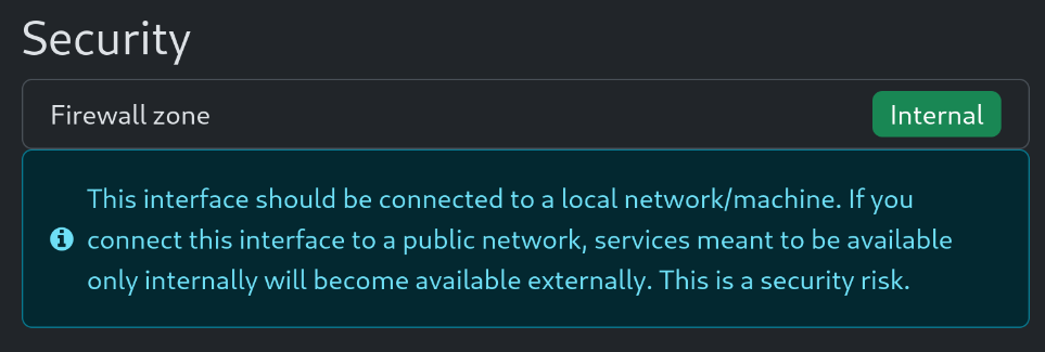

Looking at etc/sambs/smb-freedombox.conf shows on possible reason for the errors - the hosts allow listing does not include the subnet for either of the two networks I’ve got available for testing. Which means that both local networks are probably being affected by the host deny = all directive. So far I’ve not seen any way that I can change parameters that won’t be overwritten by plinth - maybe I’m missing something there
