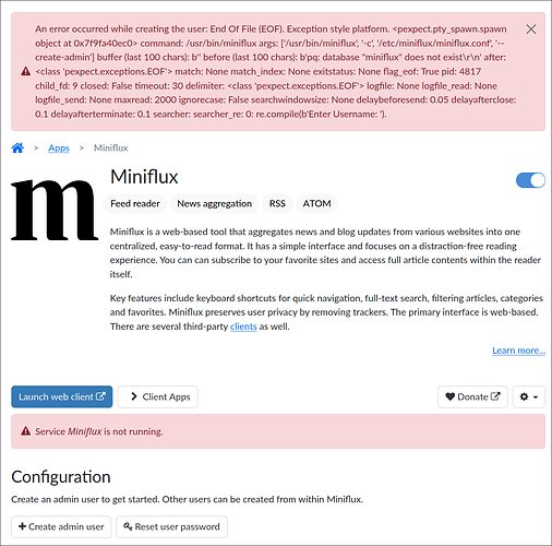

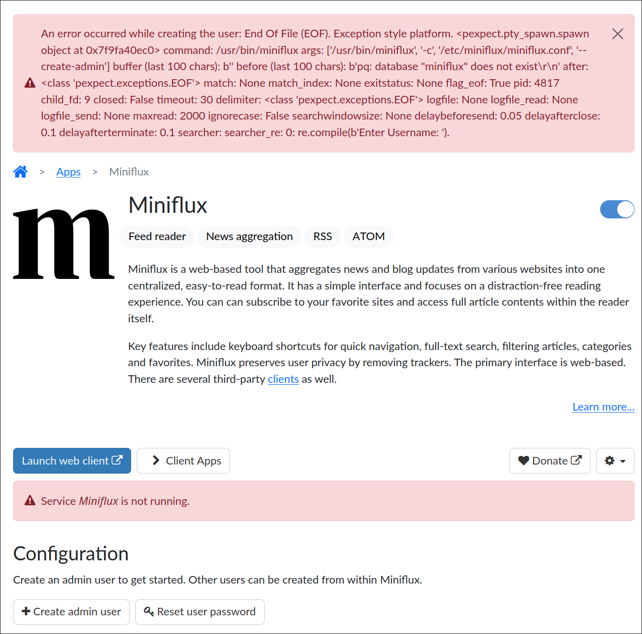

Problems installing Miniflux: “database does not exist”
Problem
I’ve tried to install Miniflux from the “Apps” section on Plinth, but the service failed to install correctly, showing this error:
Most notably: “pg: database ‘miniflux’ does not exist”
