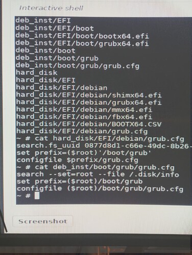

I did a reboot today, but Freedombox did not come back up. I go straight to the grub prompt. My root filesystem is btrfs.
I could use some direction to recover from this.
My “first” disk is (hd4) with /boot fs on (hd4,gpt1). I can mount that (on /hard_disk/) so the disk does work. The content is…
I cannot mount, scrub, check the btrfs /
When I insmod btrfs from grub prompt I would hope to be able to ls a btrfs volume such as (hd4,gpt3), and I cannot. yet, I know the device is working.
Grub.cfg looks like so…
Your help is appreciated. I have no Internet now, Freedombox is my router.
