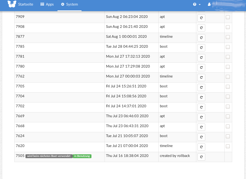

Some days ago i used a System-Snapshot to revert back because I confused ikiwiki with a video file. Since that i see that this snapshot is still in use? In the meantime I have restarted the box several times
and I see this message quota not working… when i use apt for install something and also

It irritates me that this snapshot is still in use (?) and I wonder if these problems could be related to this snapshot. However, the system is running normally. Apology for my poor knowledge
Now I’m sure my system is still based on this snapshot and my problems are related to this but how can I change that? I don’t have access during startup because I can’t connect a monitor to the box and i don’t find any grub files
