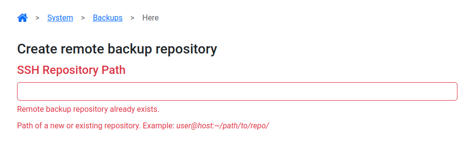

This is what happens when I try re-adding the existing repository:
I remember already trying that when I had restored freedombox in the past, and I had to create an empty repository as it wasn’t accepting to use an existing one.
You will need to remove the old backup location before adding it again. Your data on the remote server will not be removed and kept as is during this operation.
