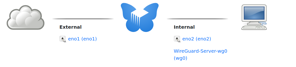

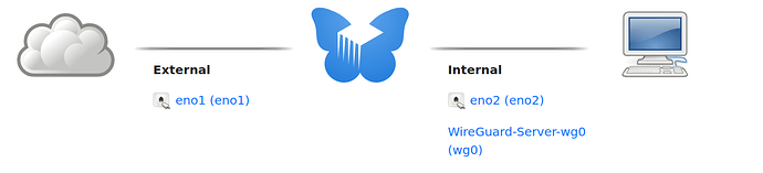

I think tun0 should be internal zone. It accepts secure connections to freedom box and is intended to be part of your local network providing access to internal services to connected clients.
Here is what I see where Wireguard is analagous to your OpenVPN…
Set that to internal, and then if it still does not work check your vpn allowed networks.

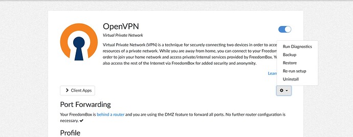

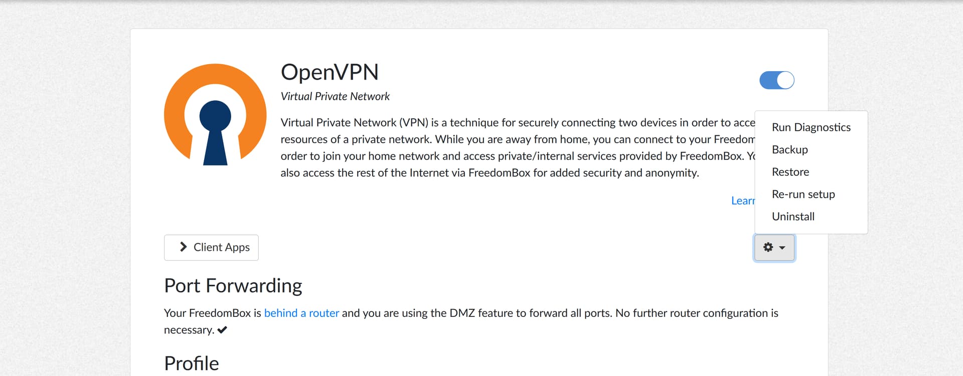

If you go to the openvpn app management page in plinth and click on the gear menu what options do you have there?
The options in the gear menu are:
Run Diagnostics
Backup
Restore
Re-run setup
Uninstall

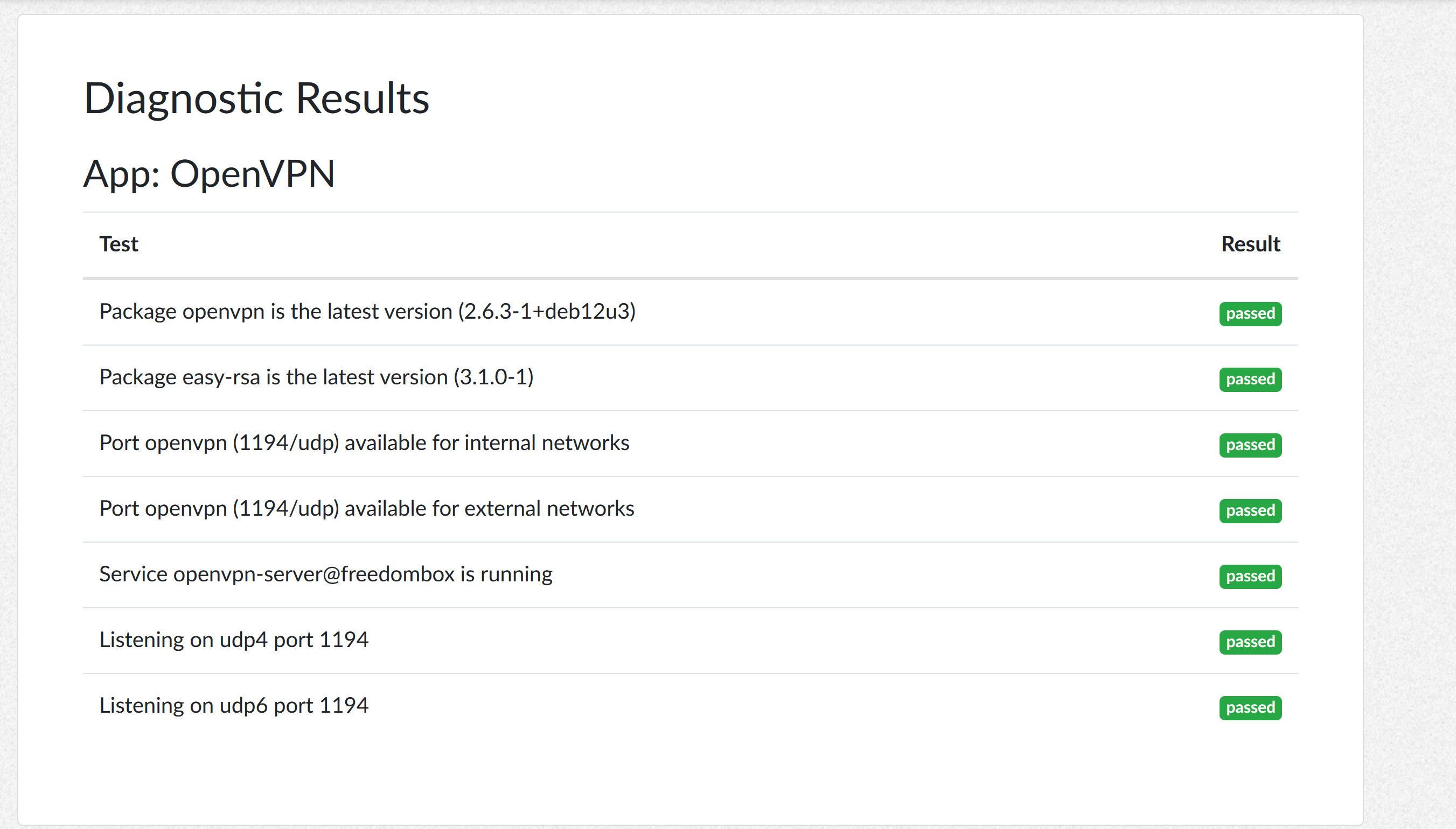

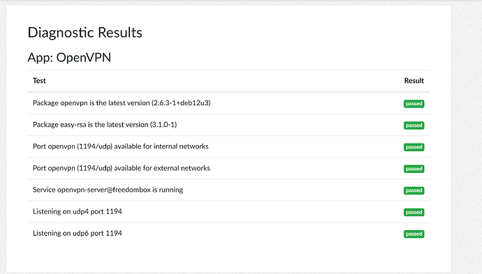

Look for bad news in diagnostics.
I’m concerned that the external firewall rule for the open VPN tunnel is part of this. Once connected to VPN when you get an IP address you should be on the inside not the outside.
This is what shows in the Freedombox UI for diagnostics.
