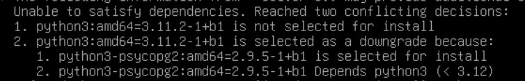

Fresh install of FB on debian trixie. Everything working except for Matrix install. Wondering if I should add bookworm repos and try again? Suggestions?
Here is the error output:
Error installing app: Apt command failed with return code: 100 Details
** **Error running action: plinth..install(app_id="matrixsynapse", packages=["matrix-synapse", "matrix-synapse-ldap3", "python3-psycopg2"], skip_recommends=false, force_configuration=null, reinstall=false, force_missing_configuration=false): RuntimeError("Apt command failed with return code: 100")** **Stdout:** **│ freedombox set on hold.** **│ Canceled hold on freedombox.** **Stderr:** **║ E: Unable to correct problems, you have held broken packages.** **║ E: The following information from --solver 3.0 may provide additional context:** **║ Unable to satisfy dependencies. Reached two conflicting decisions:** **║ 1. python3-rpds-py:amd64=0.28.0-1 is not selected for install** **║ 2. python3-rpds-py:amd64=0.28.0-1 is selected as an upgrade because:** **║ 1. matrix-synapse:amd64=1.143.0-2 is selected for install** **║ 2. matrix-synapse:amd64 Depends python3-rpds-py (>= 0.25.0)** **Action traceback:** **╞ File "/usr/lib/python3/dist-packages/plinth/actions.py", line 504, in _privileged_call** **╞ return_values = func(*arguments['args'], **arguments['kwargs'])** **╞ File "/usr/lib/python3/dist-packages/plinth/privileged/packages.py", line 69, in install** **╞ raise RuntimeError(** **╞ f'Apt command failed with return code: {returncode}')** **

I’m not familiar with Matrix Synapse, as I don’t have it installed on my FreedomBox, so I don’t know if I’m the most qualified to answer this, but I’ll try to help.
Probably, by looking at the packages from the error, I see that matrix-synapse is coming from “forky” and requires a version of python3-rpds-py that is not available on “trixie”. It is also not available on “trixie-backports” yet.
Personally, I would wait for the developers to fix this, which might take some time. However, if Matrix Synapse is vital for your use case and you don’t mind trying things you could try something like the following:
Note: Mixing suites could break things.
So, if I had to find a solution, I suppose I’d check if other packages depend on python3-rpds-py and if not, I would pin the “forky” version of the package.
You could test if installing the python dependencies from “forky” would break things by doing from the command line:
apt-get -t forky -s install matrix-synapse
Source: [SOLVED] How to upgrade matrix-synapse from stable to buster-backports? - #2 by rgb
This will do a dry run and won’t install anything but you can see if the command succeeds or fails for some reason.
If it succeeds, you can consider running it for real by removing the -s option.
This, of course, would be a temporary fix and you should probably pin it with a apt “preferences” file. That said, since the package might be added to backports in the future, you could run the command manually when needed until it becomes available in trixe-backports.

Thank You Kindly for the info. I do realize that Matrix is a fast moving target in terms of its development cycle, which isn’t in tango with Debian releases. I suppose that will continue to be the case for the foreseeable future. So any Matrix install would be a bit more temporary relative to many other packages on FB. I’ve tried the backports but it appears to be a downgrade.

However, I’d wait for the fix to arrive. According to this merge request, it has already been fixed from the FreedomBox side. We just need to wait for the package maintainer to close the issue referenced in the merge request.

I just wanted to provide a brief update, in case you haven’t heard or seen: Matrix Synapse is installable again and works fine, with some limitations. I set up a fresh trixie system last weekend, activated backports, updated freedombox to 26.10 and restored the Matrix App from a backup I made on bookworm. Worked like a charm, all data and config back in place.
Sadly, audio and video calls are not working yet, if you plan on using Element X as a client on Android/iOS, because of this issue here. But I am confident Livekit gets implemented sooner or later, so in the meantime I just use the classic Element client or Element WEB for audio/video calls, both over Coturn as it used to be.
