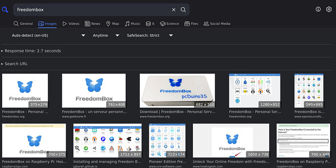

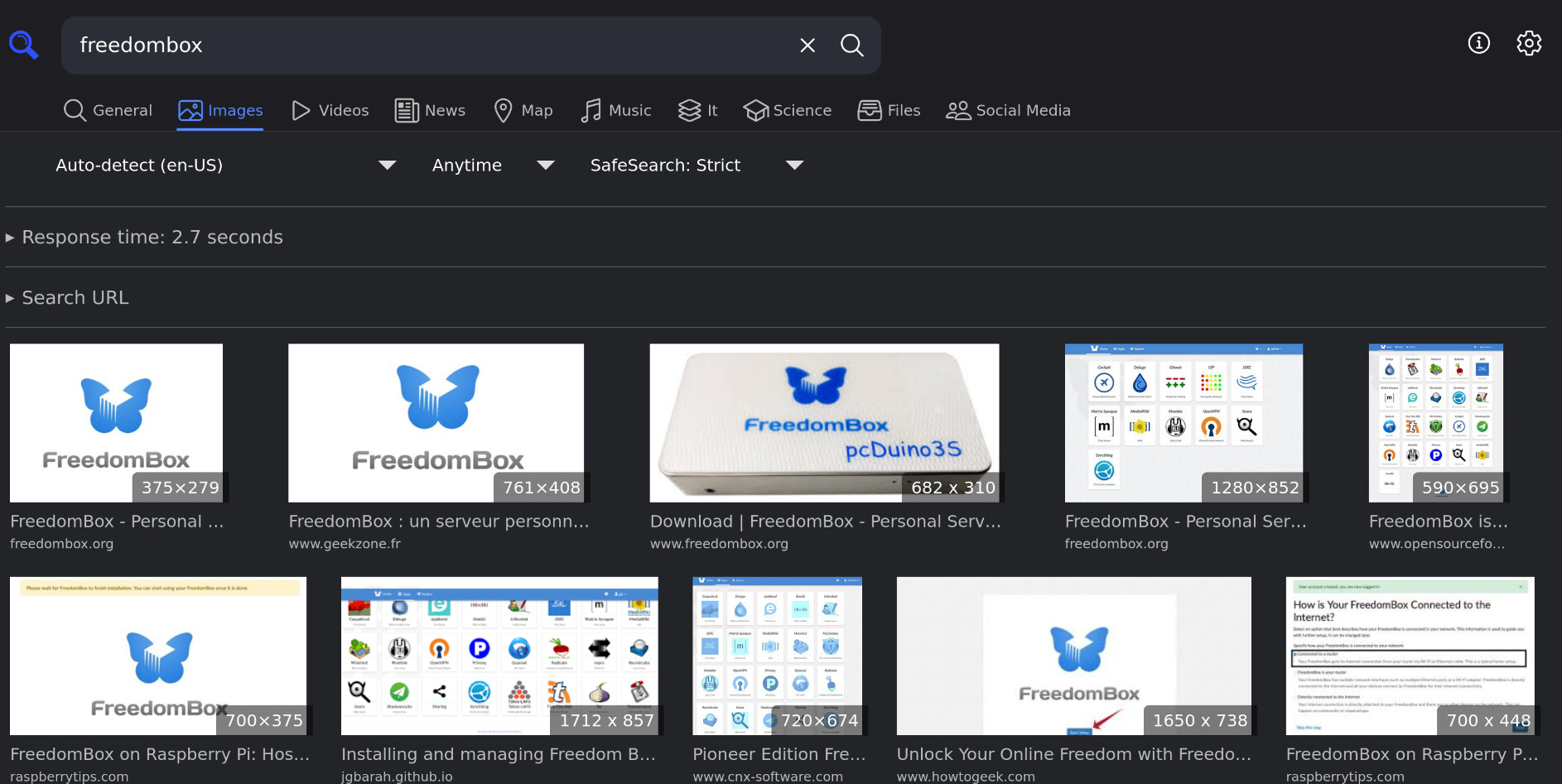

When you complete this you will be able to start searxng interactively meaning that is not a service or daemon that starts automatically. It will, however, be usable from your browser connecting to localhost:8888
