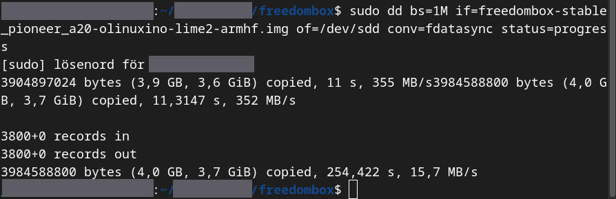

I reinstalled my Pioneer FreedomBox by downloading the SDCard image from https://freedombox.org/download/pioneer/.

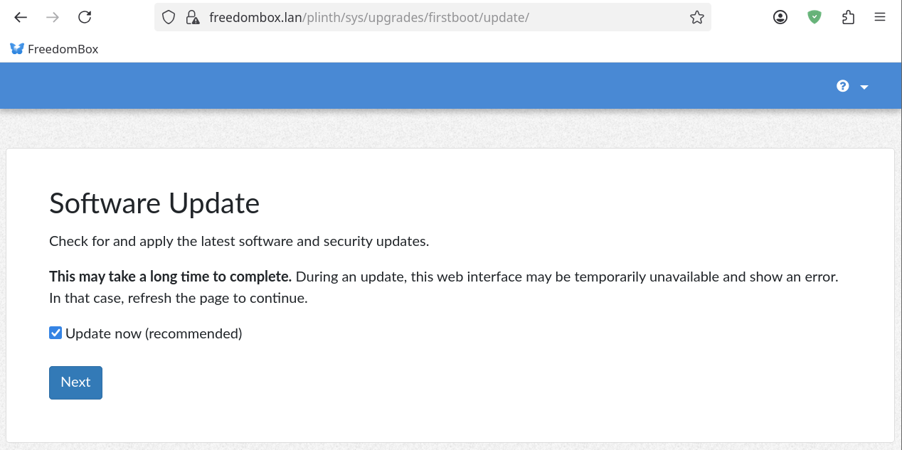

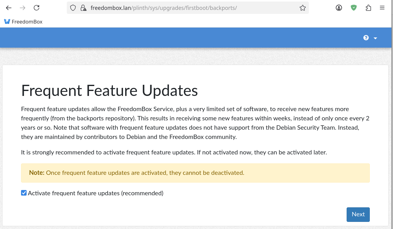

During setup, I only selected defaults (automatic updates, automatic updates to next stable version, and frequent updates all turned on).

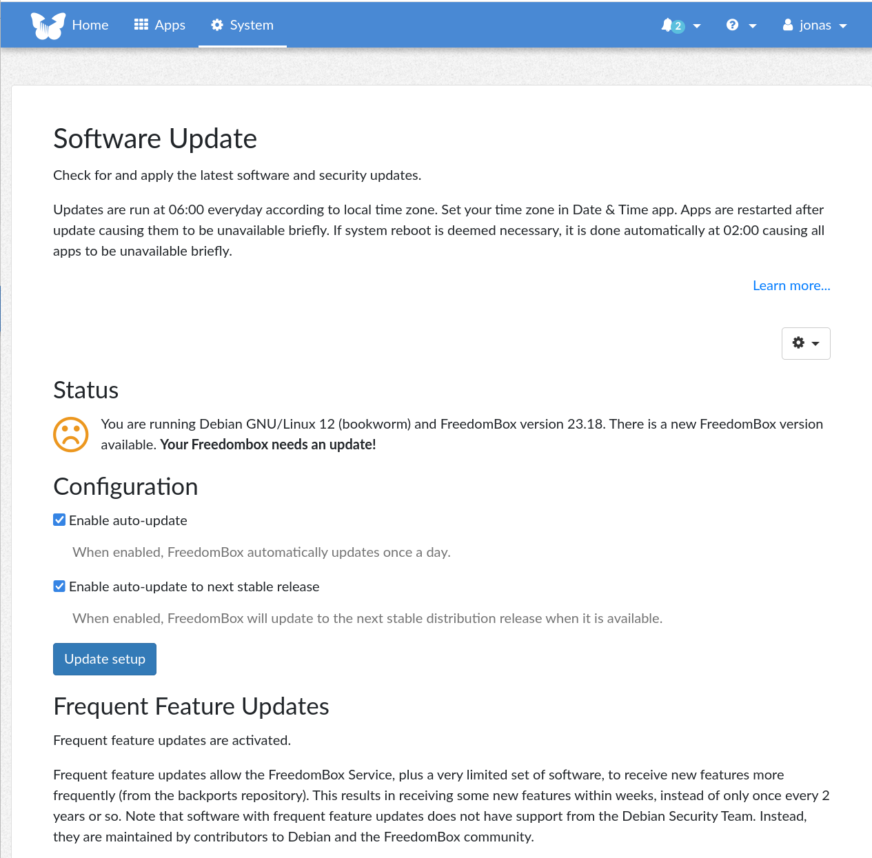

Only some packages are updated, though. FreedomBox itself refuses to upgrade past v23.18.
I’ve tried updating manually several times, and also rebooting, then updating again.
This is on a freshly installed system, using the official SDCard image, with no apps installed, and default choices.
