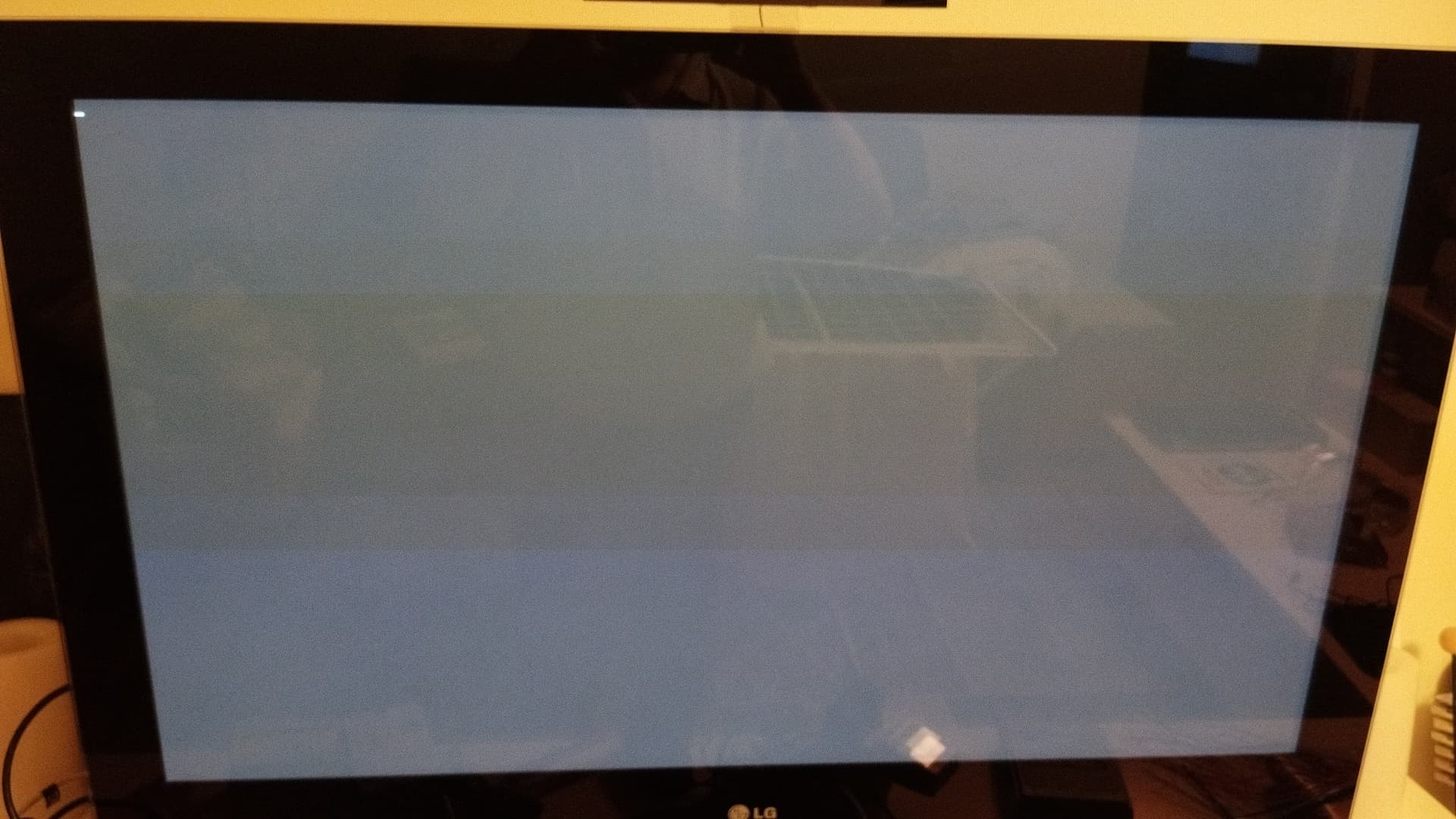

Whenever I restart my Pioneer FreedomBox, it goes through the initial boot-up process, then stops at a black screen with a tiny cursor blinking in the upper left corner. See pictures.

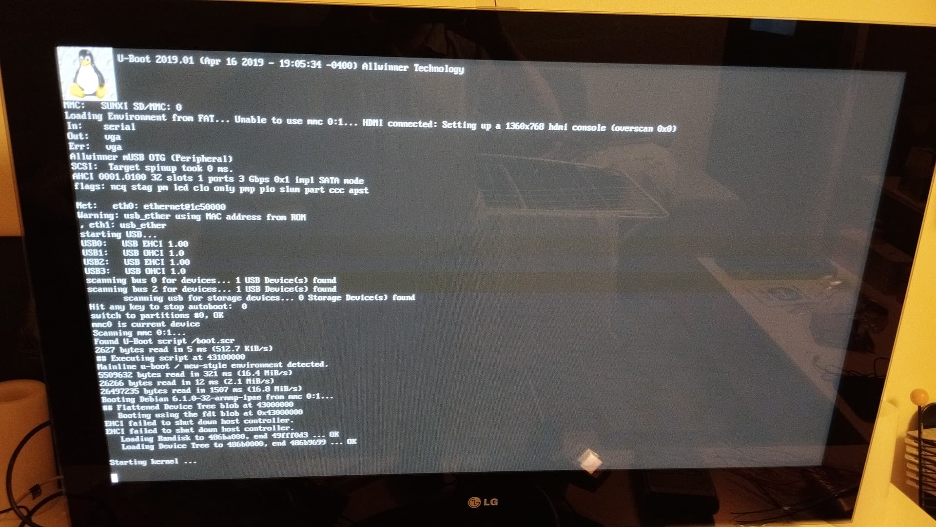

Even though many of the single board computers have HDMI port the default kernels in Debian many not have support for HDMI output. Looks like u-boot does and you are seeing u-boot output.

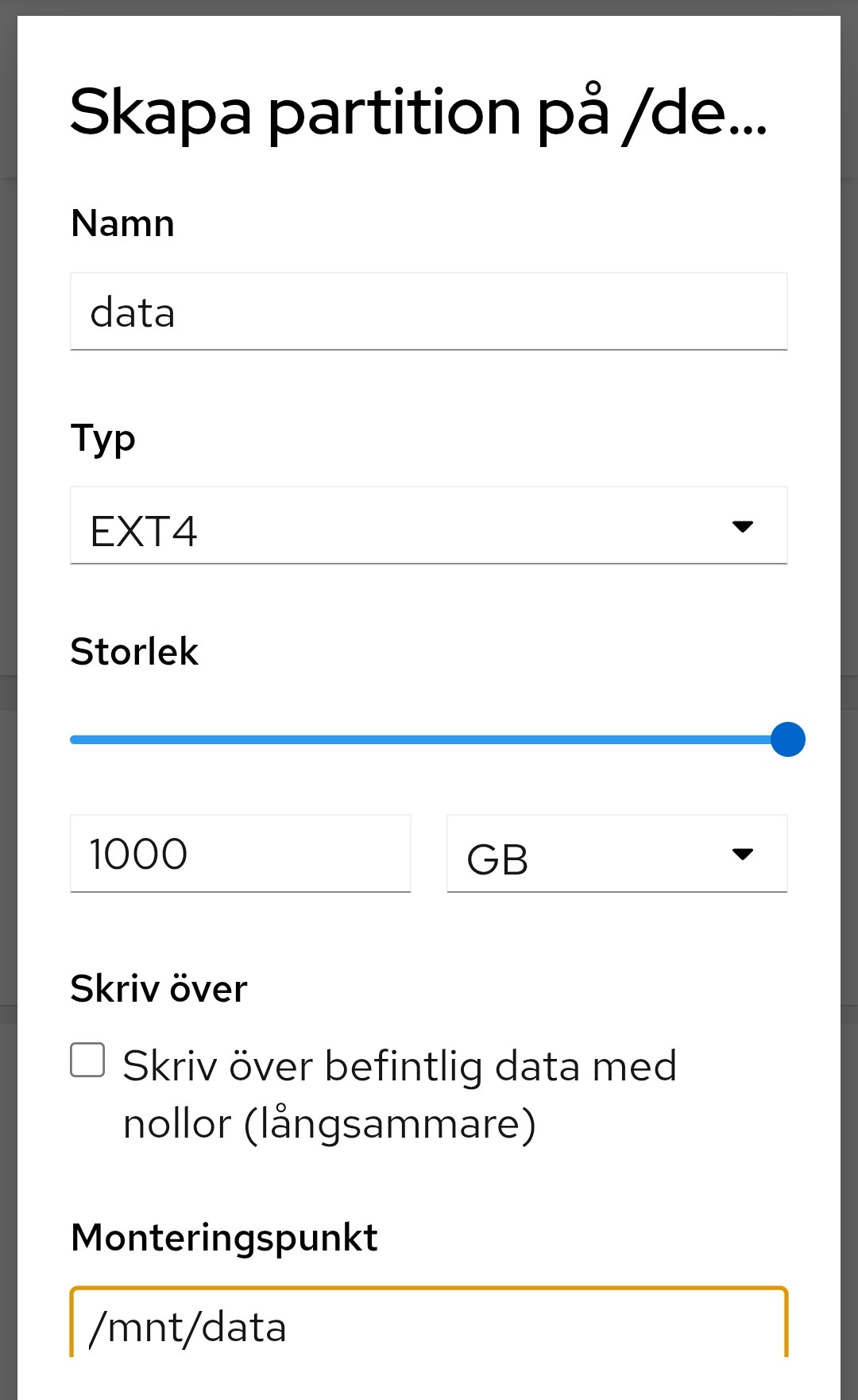

Then I used the web interface to partition my HDD with GPT, and create one encrypted ext4 partition. I don’t think I checked the button to mount it at boot.

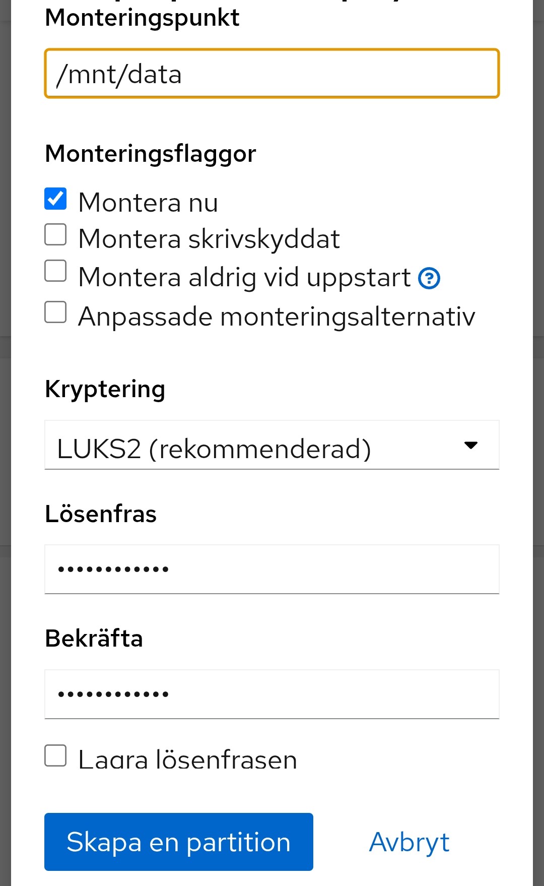

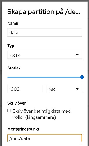

Then I created an encrypted ext4 LUKS2 partition using standard settings (see screenshots).

This seems to be a strong clue as to what is happening. From the screenshot, u-boot was able to locate and load the kernel properly.
Please report the bug. However, you are also have the best setup to track down this issue. Please continue to investigate. Since HDMI is working, please use the keyboard to interrupt u-boot’s auto-booting when it says “Hit any key to stop autoboot: …”. Then run the following at the u-boot prompt:
setenv bootargs console=ttyS0,115200 root=/dev/mmcblk0p2 rootwait rw debug
Then resume booting with:
boot.
Try to capture the kernel and systemd messages after that.
