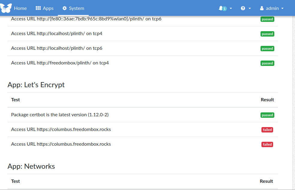

It is not possible to install the Let"s Encrypt certificate (screen1).
Diagnostic shows problems with certificate (screen 3) and DNSSEC (screen2).
