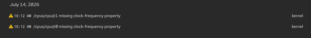

Examining the logs in Cockpit (Last 7 days, Info and above):
Records of the Jul 17th, and of Jul 5th and Jun 25th are visible.
Records around the boot-stop:
10:40 AM Starting apt-daily-upgrade.service - Daily apt upgrade and clean activities…
systemd
10:40 AM Initial clock synchronization to Fri 2026-07-17 10:40:48.962247 CEST.
systemd-timesyncd
10:40 AM Contacted time server 178.239.19.57:123 (0.debian.pool.ntp.org).
systemd-timesyncd
10:40 AM Clock change detected. Flushing caches.
systemd-resolved
