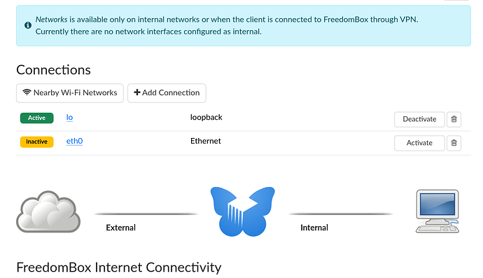

After this user as been setup I go to fbx Network page to set the firewall for external.
Here is a screenshot of that first Network page:

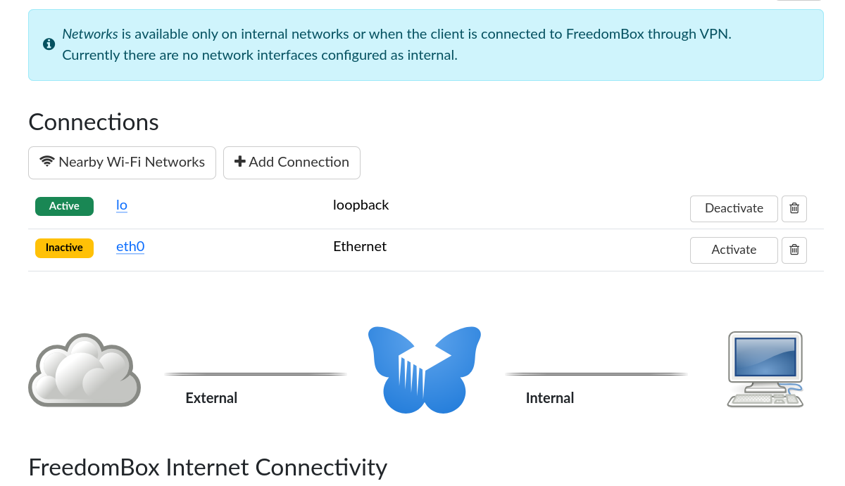

I configured the network setup as shown in the below screenshot:
It looks a perfect network setup.

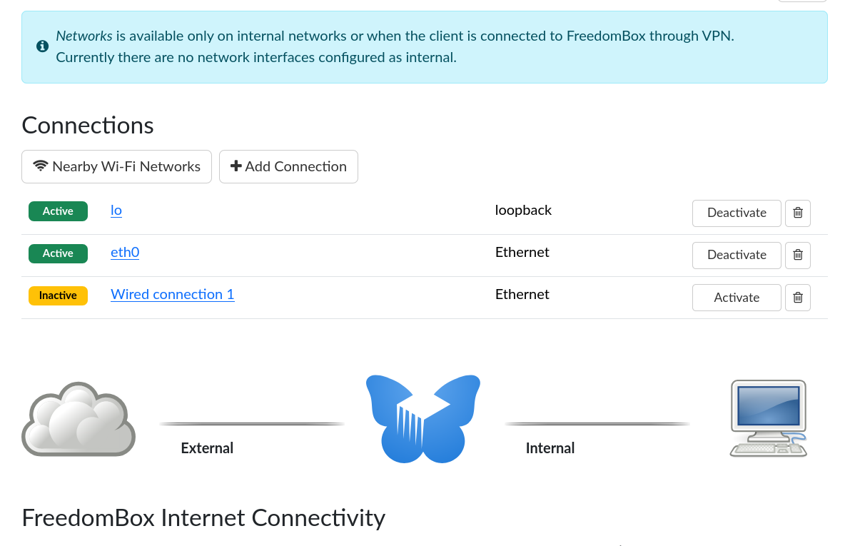

Reboot boot and login and have a look at the Network page - shown below in the screenshot:
The previous network setup has gone.
Note :
NetworkManager will not let go of lo
eth0 needs to be Activate
lo need to be Deactivate.

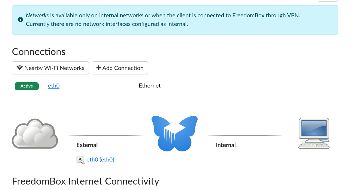

Now the tweaks are done, its a reboot.

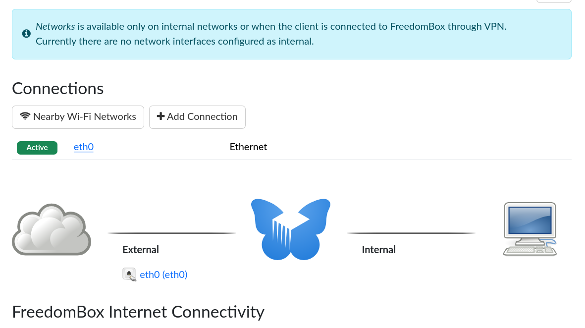

Screenshot below:
It is now back to the correct network setup. !!

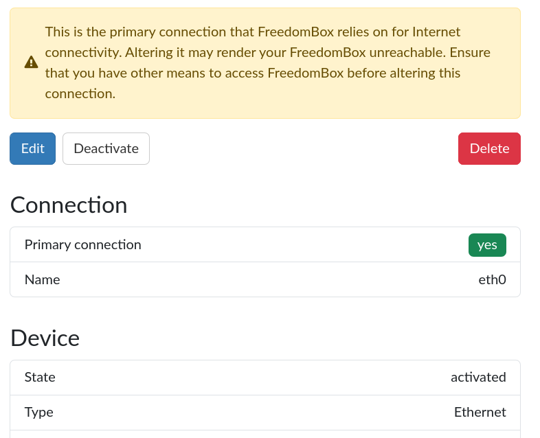

Hope the above can be useful, below is a bit more info about NetworkManager and the VPS.
Screenshot of the connection info shown below:
