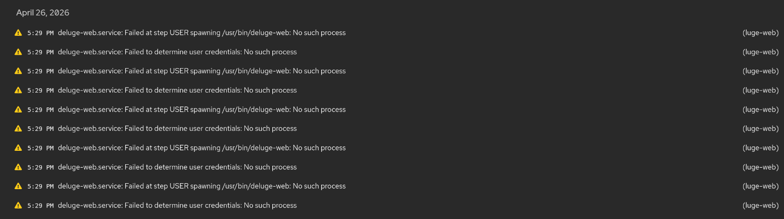

Digging a little deeper in logs I find this:
/usr/lib/freedombox/freedombox-privileged
Error running action: deluge..setup(..): Unable to setup configuration
stdout:
○ deluged.service
Loaded: masked (Reason: Unit deluged.service is masked.)
