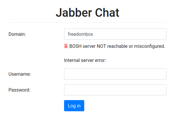

When I click on the link to open the JSXC app:
  • the “Domain” field is by default setup to “freedombox”
  • there is a non-displayable character
  • there is an error message “BOSH server NOT reachable or misconfigured”;
If I write in Domain the real domain name, then the error message disappears.
I previously had “freedombox” setup as the first domain, I removed it, but the field is still set to “freedombox” by default.
Is there a way to have it set to the first domain by default?

Thanks for the suggestion, this has fixed the problem indeed.
I still have the character that is not displayed properly. Searching a bit more, I find it is part of unicode Private Use Area which probably implies that it may not be displayed on a number of computers. I don’t know whether this is part of JSXC and should be raised to JSXC developpers, or of plinth.
