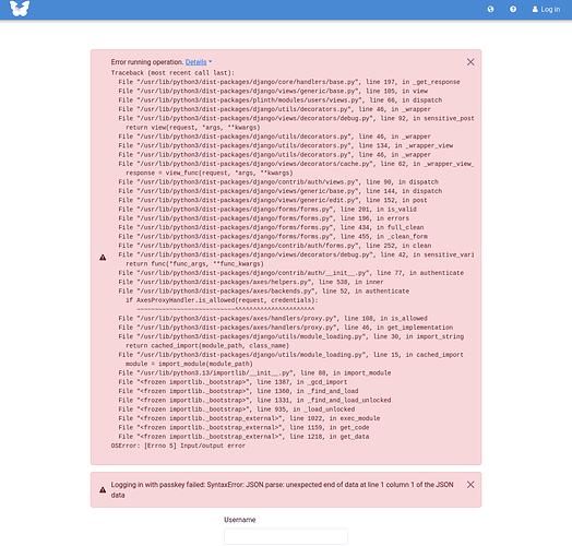

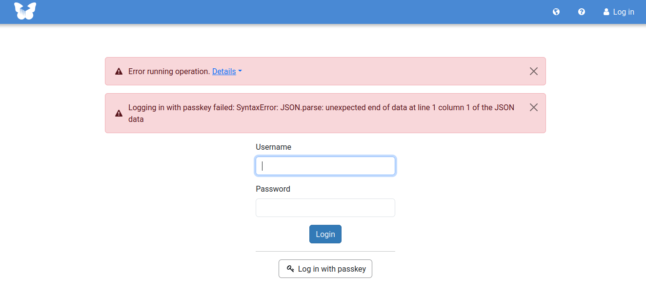

On a freedombox running on raspberry pi, access via the usual domain name fails, and if I try via the local IPv4 address, here is what happens when I type the user name and the password (actually, I do a copy from the password manager) and click on “Login” (not “Log in with passkey”, that I never used):
If I expand the message, I have:
I tried another user, the result is exactly the same. I tried via ssh, where I think it used to work, it says permission denied after I enter the password.
After removing the power and putting it back, it works normally. This freedombox only has nextcloud and I have not used it for a while. No clue what happened.

Hi Peter,
I did not try to use a passkey, I used the normal login button but got an error message referring to passkey, which looks like an incorrect behaviour to me.
