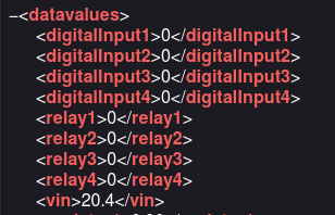

The controllers will output xml state and accept xml commands so I don’t necessarily need a graphical browser.
http://192.168.1.2/state.xml
(read the values)
(https://192.168.1.2/state.xml?relay01=1)
(turn on relay1)
