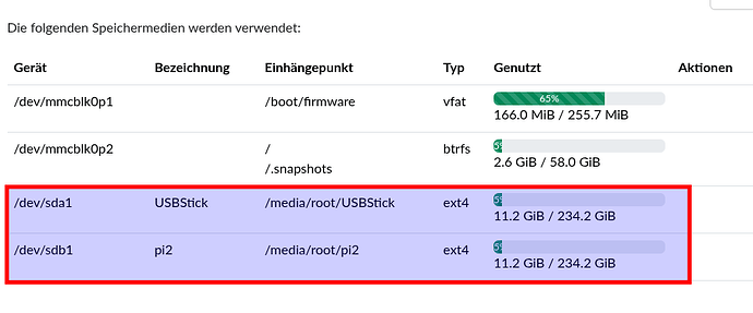

At first, I thought it might be because the USB sticks weren’t mounted automatically, so I changed this in the Cockpit. Now the sticks are always mounted automatically, even after a reboot.
But this didn’t change anything.
Then I thought I had to create the backup path via the console using the mkdir command. But the console output showed that the path already exists. However, the storage medium isn’t selectable when creating the backup. It seems that it can only be saved to the SD-card.

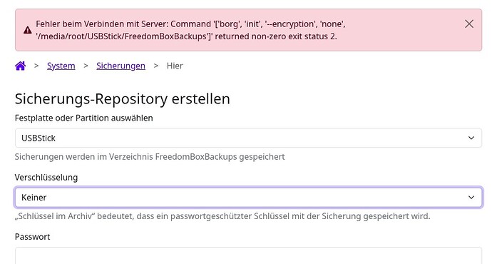

After updating Freedombox to version 25.10 I tried it again. Now there appears the message “Fehler beim Verbinden mit Server: Command ‘[‘borg’, ‘init’, ‘–encryption’, ‘none’, ‘/media/root/USBStick/FreedomBoxBackups’]’ returned non-zero exit status 2.”
So I manually removed the cache directory by deleting the contents of /root/.cache/borg, which forced Borg to recreate the cache files during the next backup operation. But it dididn’t work. The message appeared again.

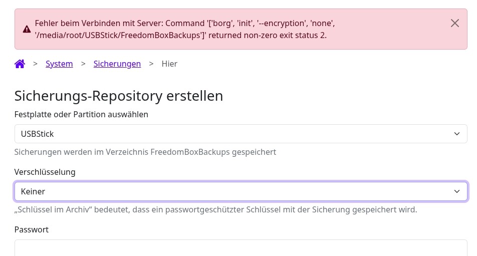

Just a naive question based on your screenshots: On top there are screenshots where it seems that you were using a passphrase for your backups, and at the end you’ve set encryption to ‘none’ (German ‘Keiner’). Could this be the cause that the borg command fails?
The screenshots are a bit confusing. I tried the following combinations:
  1. Hard drive or partition “USB stick”, encryption: “Key in repository” and passphrase
  2. Hard drive or partition “USB stick”, encryption: “None” and no passphrase
Do you have the option to log into the machine with SSH or via Cockpit and try to run the borg commands from the command line? This would allow passing a verbose-flag (-v) to maybe see more details about the root cause.
I now suspect that the connected USB sticks might not be writable for Freedombox. But I don’t know how to change that.
Yes I have the option to log into the machine with SSH or via Cockpit and I could try to run the borg commands from the command line. But I dont’ know the commands.
Just going by the error message in your screenshot above (red box) I would assume:
borg init --encryption none /media/root/USBStick/FreedomBoxBackups
You may probably need to run this as root user and may want to give the verbose-option I mentioned:
sudo borg init --verbose --encryption none /media/root/USBStick/FreedomBoxBackups
That may give some info on what is going wrong.
Permission denied to /media/root/USBStick/FreedomBoxBackups.
pi@freedombox:~$ sudo borg init --encryption none /media/root/USBStick/FreedomBoxBackups
[sudo] password for pi:
A repository already exists at /media/root/USBStick/FreedomBoxBackups.
pi@freedombox:~$ sudo borg init --verbose --encryption none /media/root/USBStick/FreedomBoxBackups
It was my stupid mistake, which I now realize: I had already connected two USB sticks with Freedombox and Debian Bookworm. Then I uninstalled Freedombox and reinstalled Freedombox with Trixie. I simply connected the USB sticks with the existing backups. That’s why Freedombox is complaining, saying the repository already exists.
I’ve now unplugged the USB sticks and deleted the backup repositories on the desktop computer. Then I reconnected the USB sticks and recreated the repositories. Everything works now! Thanks for your effort! The problem is solved.
