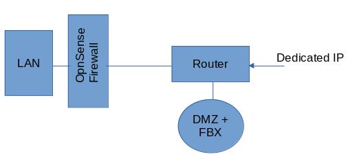

@major_ludd does your configuration look something like this:

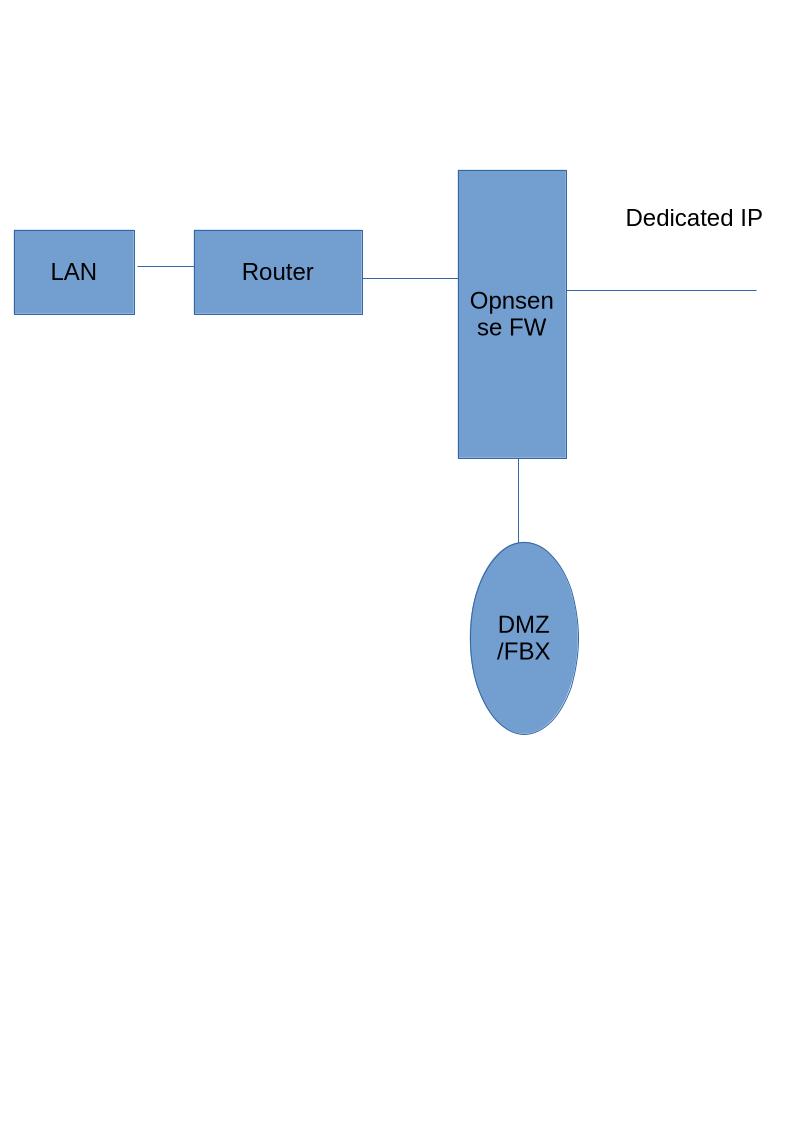

Not quite, the Router is to the left of Opnsense FW; which is directly above the DMZ/FBX
After much ado, I managed to create a graphical format!!
@major_ludd thanks for the diagram. Looking at this configuration, there are 3 firewalls: router firewall, opnsense firewall, and the freedombox firewall. Also the router itself, the opnsense firewall, and the freedombox are capable of routing traffic. Does that seem right?
To test my understanding, is it true that a device on your LAN can communicate with the FBX in the OPNsense DMZ? Is the freedombox in the same subnet as your other LAN devices, e.g., 192.168.0.1/24 or similar?

It seems right for my purpose. I mentioned in a previous post, I have no requirement to access the FBX from the LAN. All communication with this device is to be via WAN. My primary aim is to protect my LAN from potentially untrusted devices - that includes the FBX device and software.
Please see my answer to your previous question. In summary, my LAN cannot communicate with FBX, except by going out over WAN.
One salient point worth making, the dedicated IP provided by my ISP is in fact several public IP addresses. Each address is routed thro’ the Opnsense FW to individual servers within the DMZ. One of which is of course the FBX. The LAN too gets a dedicated public IP.
