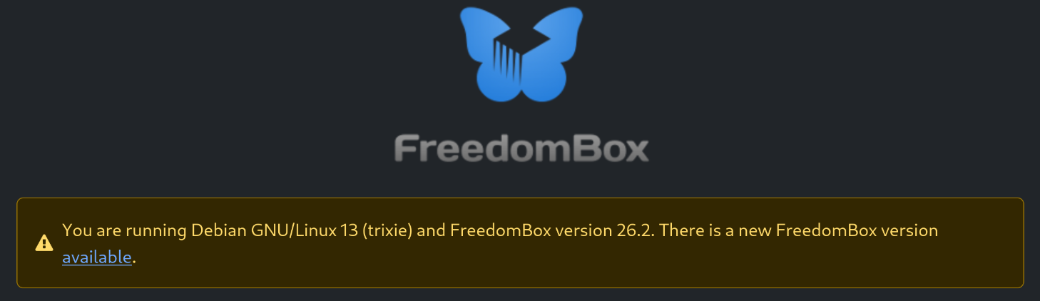

FreedomBox about page gives this message:
You are running Debian GNU/Linux 13 (trixie) and FreedomBox version 26.2. There is a new FreedomBox version available.

Help / About tells me…
