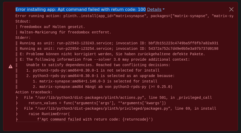

Just set up a Freedombox on a Debian machine. Can not install Matrix Synapse.
  1. Login to FreedomBox.
  2. Go to Apps Page
  3. Go to Matrix Synapse
  4. Click Install
Installation of Matrix Synapse
I get an error with the following message:
Error installing app: Apt command failed with return code: 100
  • FreedomBox version: 26.7.1
  • Hardware: Intel NUC
  • OS: Debian 13 (trixie)

I just encountered the exact same problem. Here’s a paste of the error message so it’s a bit more searchable:
Erreur lors de l’installation de l’application : Apt command failed with return code: 100 Details
Error running action: plinth..install(app_id="matrixsynapse", packages=["matrix-synapse", "matrix-synapse-ldap3", "python3-psycopg2"], skip_recommends=false, force_configuration=null, reinstall=false, force_missing_configuration=false): RuntimeError("Apt command failed with return code: 100")
Stdout:
│ freedombox passé en figé (« hold »).
│ Annulation de l'état figé pour freedombox.
Stderr:
â•‘ Running as unit: run-p28273-i28573.service
â•‘ Running as unit: run-p28285-i28585.service
║ E: Impossible de corriger les problèmes, des paquets défectueux sont en mode « garder en l'état ».
â•‘ E: The following information from --solver 3.0 may provide additional context:
â•‘    Unable to satisfy dependencies. Reached two conflicting decisions:
â•‘    1. python3-rpds-py:amd64=0.30.0-1 is not selected for install
â•‘    2. python3-rpds-py:amd64=0.30.0-1 is selected as an upgrade because:
â•‘       1. matrix-synapse:amd64=1.146.0-3 is selected for install
║       2. matrix-synapse:amd64 Dépend python3-rpds-py (>= 0.25.0)
Action traceback:
╞   File "/usr/lib/python3/dist-packages/plinth/actions.py", line 501, in _privileged_call
╞     return_values = func(*arguments['args'], **arguments['kwargs'])
╞   File "/usr/lib/python3/dist-packages/plinth/privileged/packages.py", line 69, in install
╞     raise RuntimeError(
╞         f'Apt command failed with return code: {returncode}')
Freedombox version is 26.7.1 on Debian 13.
My understanding is that matrix-synapse got removed from testing a few days ago, so should we just wait for it to reach testing again?
