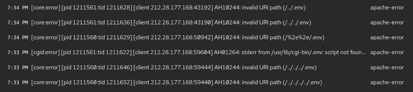

I have a heap of log entries like this today:
Some AI tells me that this is caused by a client trying to execute a PHP script I don’t have or to which they do not have permission. It appears there’s an app for that: fail2ban apache-noscript
The outcome I’d like is for these clients to get banned, so I’m going to try out a new fail2ban jail which I’ve never done before. I’m going to lean on the freedombox configurations and see if I can’t get this right.

in the filter line - and if you look at the screen capture that is also an apache-error log entry. It looks like all we do is enable the new jail with the same configuration elements.

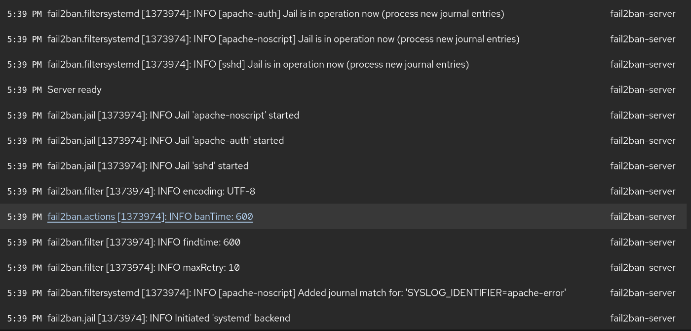

And that started without errors.

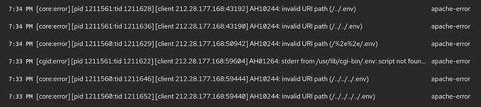

In the latest batch of malicious log garbage there was only one ‘Primary script unknown,’ so it did not trigger a ban (I didn’t have maxretry set as 1). But, I did see this!

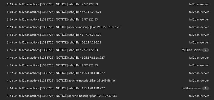

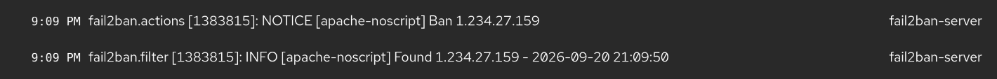

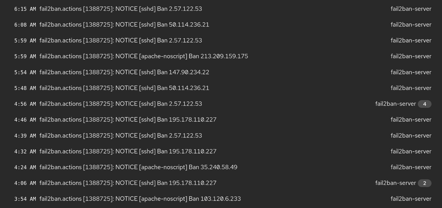

Banned.
Note the maxretry = 1 for noscript and overflows. Those cover actions that you as a user would not do by mistake - and the ban is applied immediately. This one was banned after the first attempt. Once I’m comfortable with this I’ll increase the bantime from 600 seconds to hours or a day.
You can easily test noscript with https://freedombox/this-script-does-not-exist.php. You’ll ban yourself if you have maxretry = 1, but then you’ll know it’s working as you expect. Unban yourself with sudo fail2ban-client set apache-noscript unbanip <YOUR_IP>
apache-noscript seems to be the one. I reduced maxretry from 10 to 3 for sshd, and maxretry = 1 for apache-noscript. After running overnight I have more bans per period and multiple apache-noscript bans.
What, if anything did this accomplish?
Probably less than one would hope, but there are
  • reduced log entries about this stuff
  • better log entries when they get banned :slight_smile:
